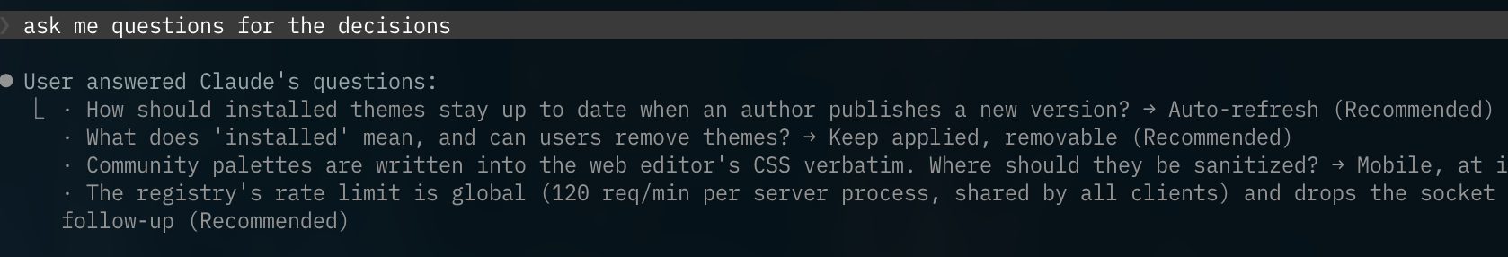

2. Have the agent ask you questions for the decisions
The plan often includes decisions that only you can make. Tell your agent to ask you about them:
Asking the agent to ask questions for the decisions

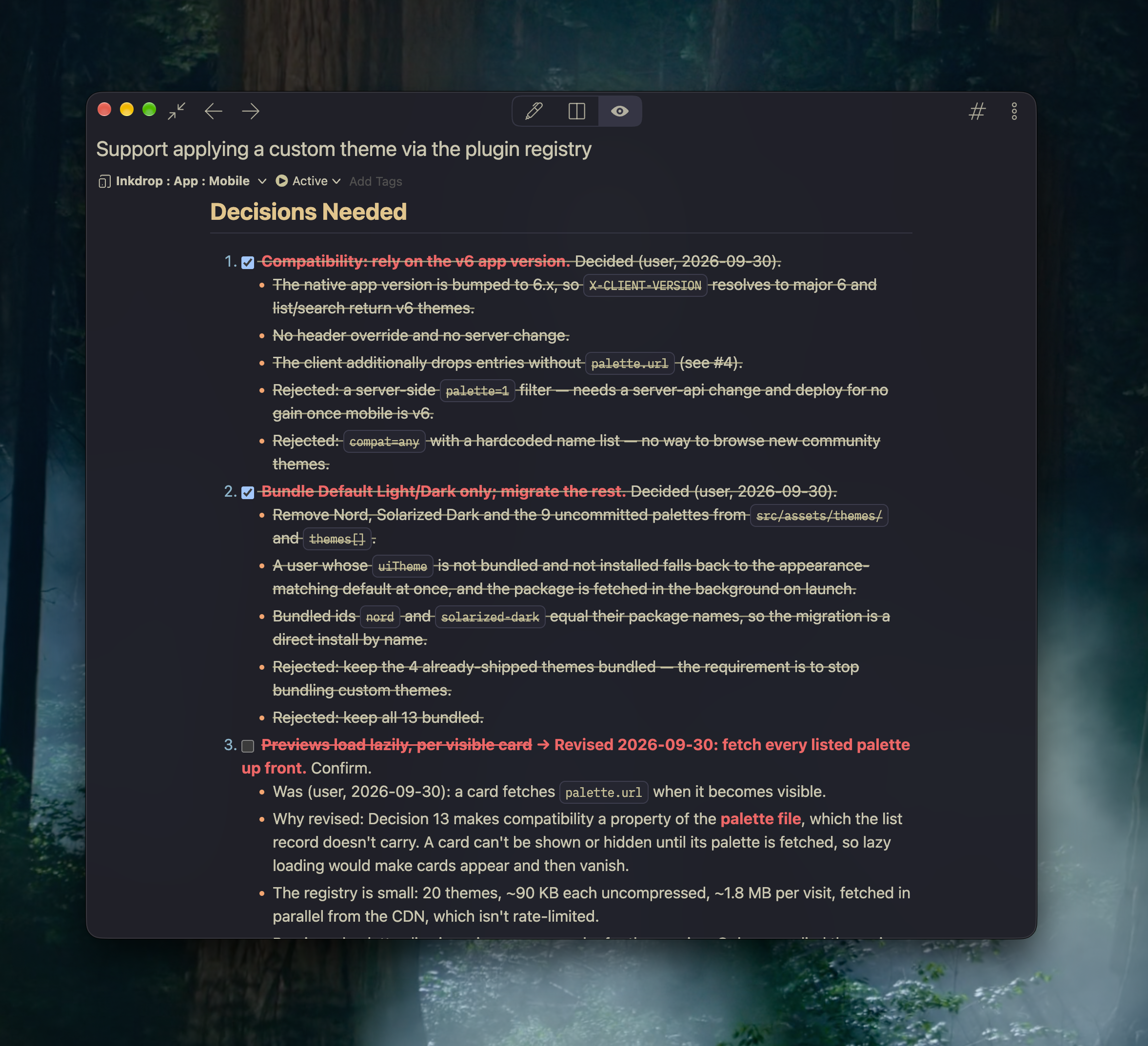

It suggests options for each question, and updates the Decisions Needed section with your answers. Settled decisions are checked off with the reason and the rejected options, so you can look back at why the plan looks the way it does:

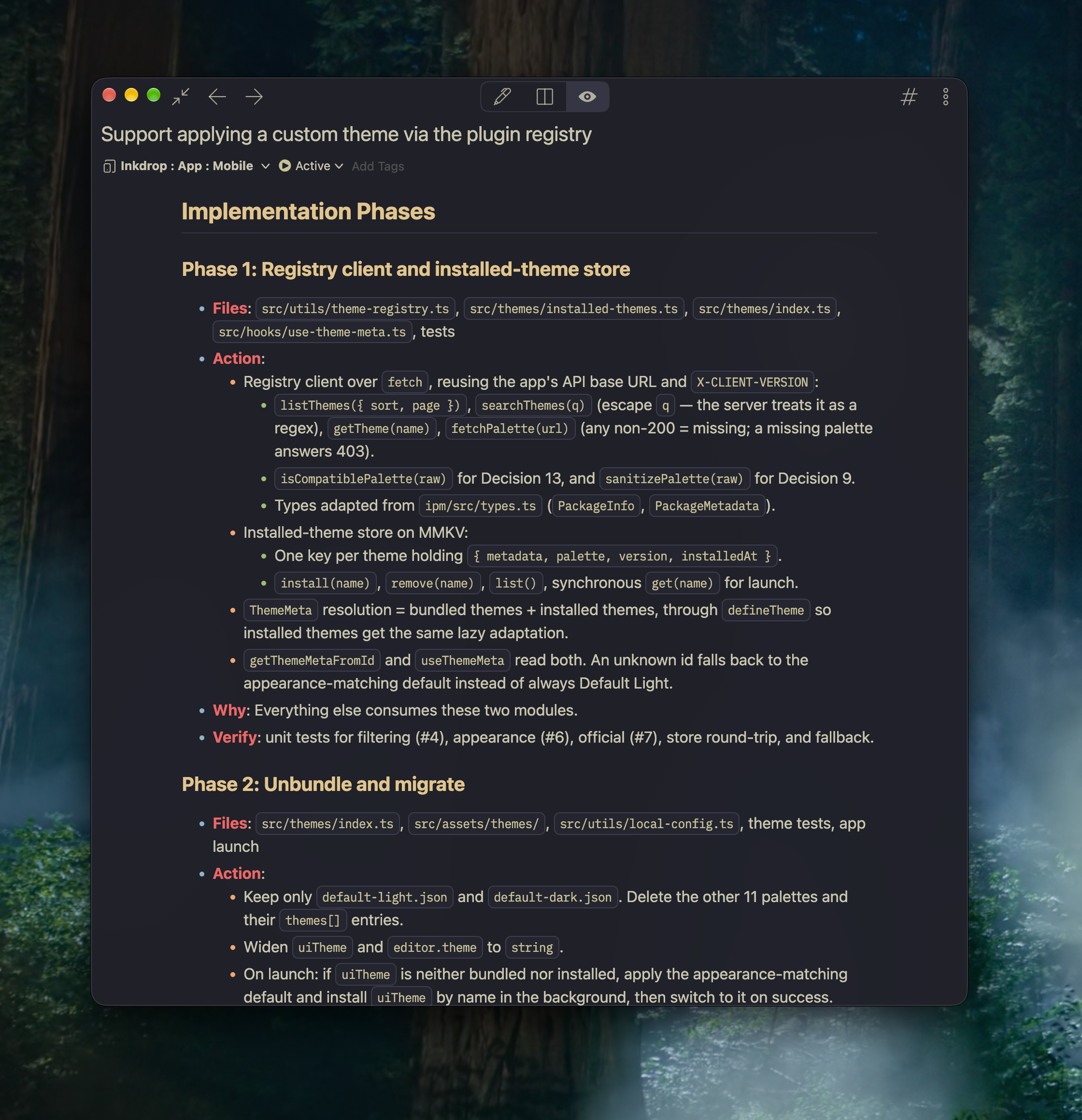

3. Review the phases
Next, read the Implementation Phases section. Check:
  • Which files will be updated or created
  • Whether any points are missing
If something looks off, edit the note directly or tell the agent to fix the plan. Fixing a plan is much cheaper than fixing code.

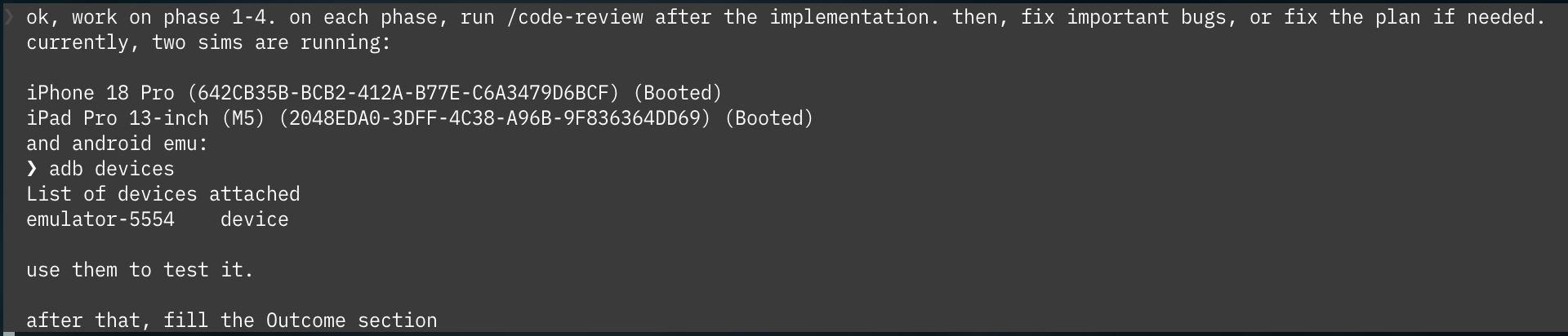

4. Have the agent implement each phase
If you are comfortable with the plan, have the agent implement all the phases. Let it run a reviewer agent (like /code-review) after each phase and fix bugs, or change the plan if necessary:
Asking the agent to implement the phases

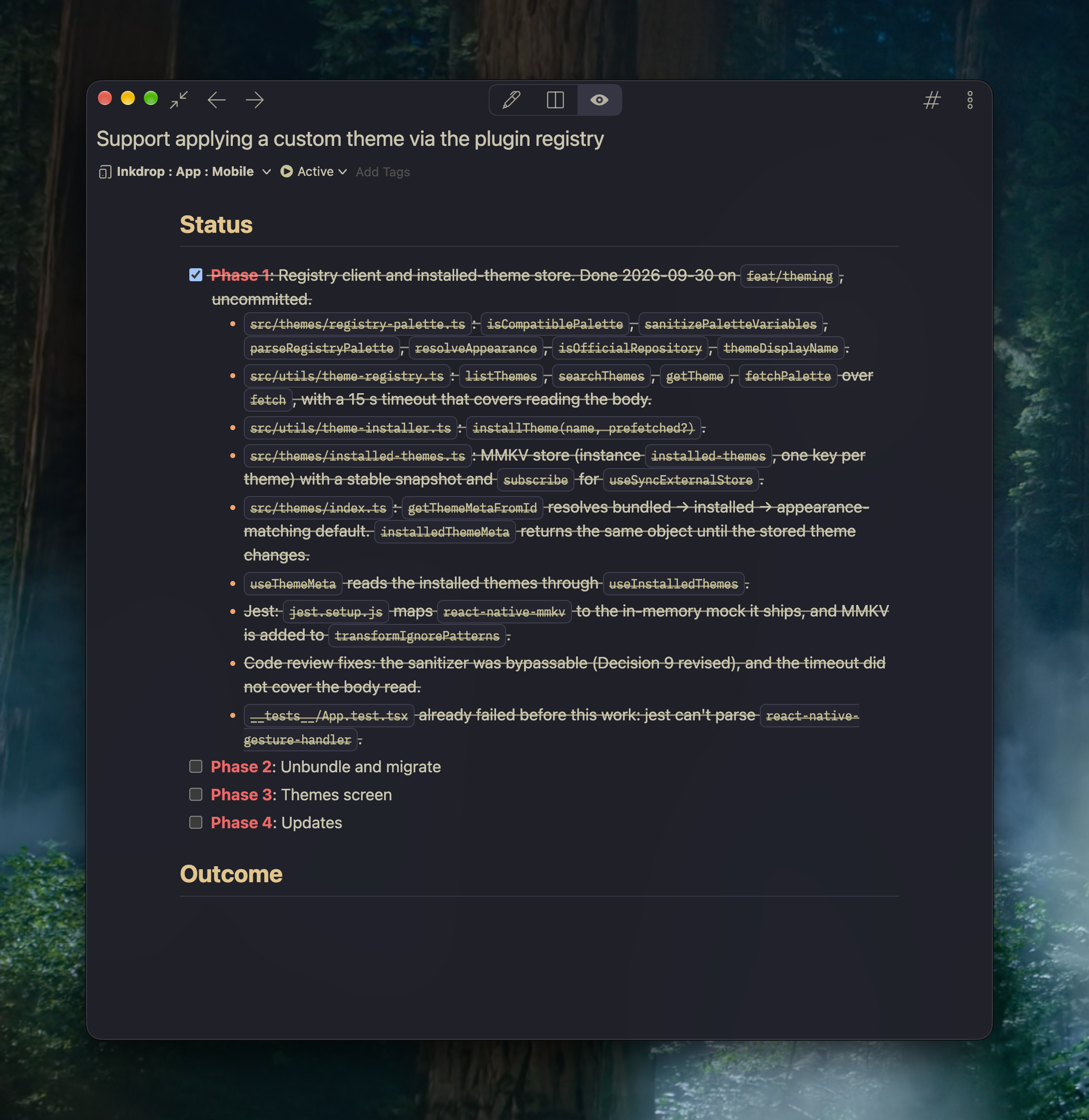

The agent updates the Status section after finishing each phase, so you can watch the progress right in Inkdrop:
Status section
